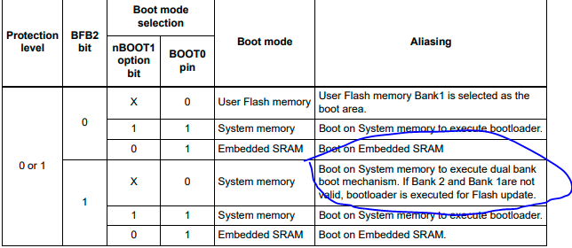

Jumping to the bootloader is not the issue now.its jumping to bootloader from user app and as it sees the valid code in user bank1/2 its jumping back to the user app.
Referring to AN2606(system memory boot mode)
below is the only case where bootloader will go to flash update
0693W00000FE4InQAL.pngi need to achieve above conditions so that it will go to dfu. i tried to erase the bank 1 and 2 but no luck. need some more information on it.how can i erase the both banks before jumping to bootloader from user app?
PLease correct if my understanding is wrong.working first time on STM device

Setting flash to 0 is not the same as erasing it. The erased value would be 0xFFFFFFFF.
