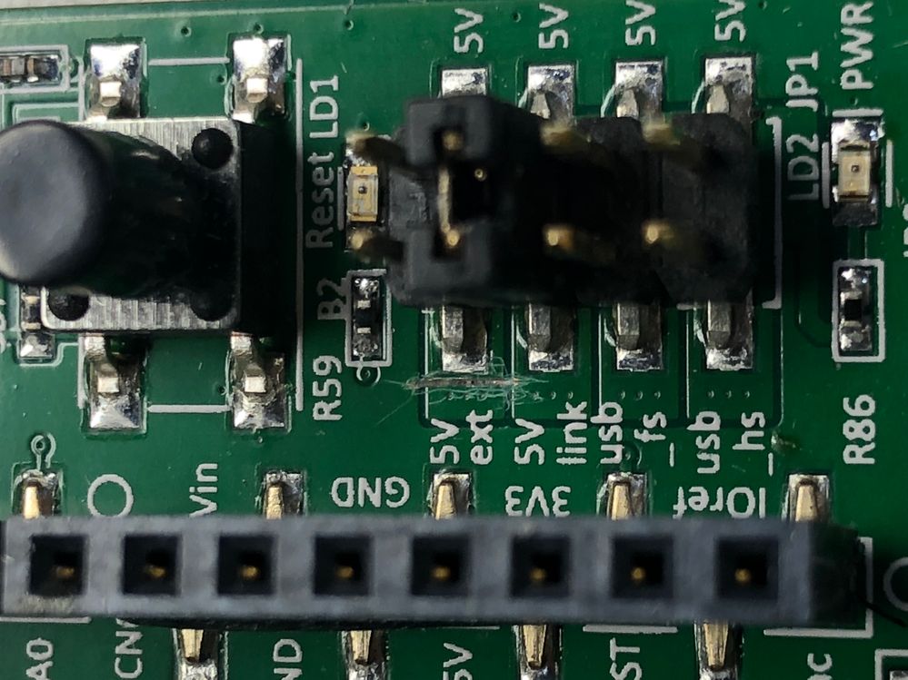

I'm trying to power a STM32F746G-DISCO board from the CN6 VIN pin.
I have a voltage regulator that output 11VDC current.
The screen turns on but the program never start and LD6 and LD3 become red after a few seconds.
I measured the current between GND and VIN, it's 11VDC , during few seconds, the it go down to 3.3V.
I measured the VO from the voltage regulator without connecting it to the board, and it's 11VDC stable.
The jumper is on V5ext, as explained in the documentation.
What is wrong with that setup ?
Everything works fine with USB.

So I tried with a R-78E5.0-0.5 connected directly to the 5V arduino PIN and it works great.
I also tried a with a R-78C9.0-1.0 connected to the VIN PIN, which sound more logic for me because it's a VIN pin (that should be between 7 and 12V regarding specs) but that didn't work.
I want to use arduinos pins because I printed a bread board and I don't want to use the JP1 connector.
Is it ok to power the board through the 5V arduino PIN ? The documentation doesn't list it as a possible powering connector.
Do I have to add some capacitors with the R-78E5.0-0.5 to protect the board ? The datasheet doesn't say it's necessary. But what would you do ?

NMath.8
No, I plugged the R-78x directly to the DISCO board, without any other parts.
It cost me one board because of a wrong plug (9v --> 5v arduino pin) :). But now I know I have to be very carefull. Also, I can't use USB port while the board is powered by 5V pin, but I will deal with that.
Is it recommended to add 10uF capacitors with the R-78E5.0-0.5 ? It work fine without, but I saw on some posts it was recommended with other DC/DC converters.

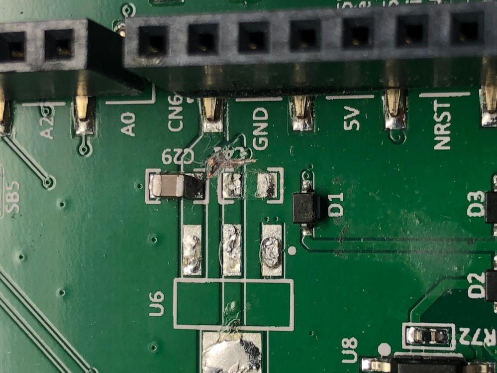

Not sure if anyone else has run into my issue, but this seemed like a good place to post it since it's somewhat related and I landed here while looking for answers.
I was having very similar problems using the "VIN" pin on the Arduino header. I have two of these STM32F746G-Disco boards and they both had the same problem... The V-Out pin on U6 (5V reg) was shorted directly to ground (in the PCB, even after removing components).
A little board modification to cut the connection at both ends and route a new wire over to the jumper header and now they both work perfectly.
Maybe there's something else I missed somewhere and someone here can point that out, but this did the trick for me. I hope it can help someone else =)
