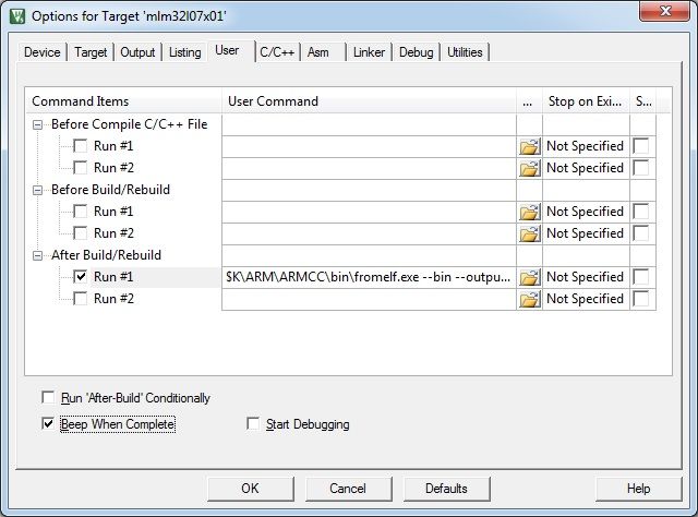

I'd like to make and upload the firmware file into STM32F103C8 board by using UART.
Especially, STM32F103C8 board have boot mode switch and uart connect.
How to make firmware *.bin file to upload to STM32F103C8 by using MDK?
Posted on November 07, 2017 at 05:23
After Build/Rebuild, Run ♯ 1
, figure you are processing the .AXF after the linker has generated it. Pretty sure there is documentation.0690X00000604CFQAY.jpg

Posted on November 07, 2017 at 04:59
Keil has a FromELF utility, you can run it from the user tab to build a .BIN file.
$K\ARM\ARMCC\bin\fromelf.exe --bin --output=@L.bin !L

Posted on November 07, 2017 at 05:02
Go to your toolchain project settings, probably as linker or post linker option where you can generate optionally a MAP, BIN, HEX or SREC/S19 files.

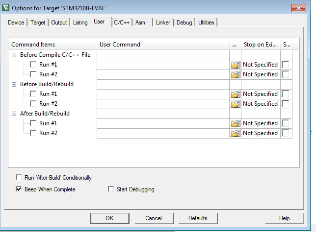

Posted on November 07, 2017 at 05:14
Would you mind let me know what should I do for applying ''
$K\ARM\ARMCC\bin\fromelf.exe --bin --output=@L.bin !L''?
