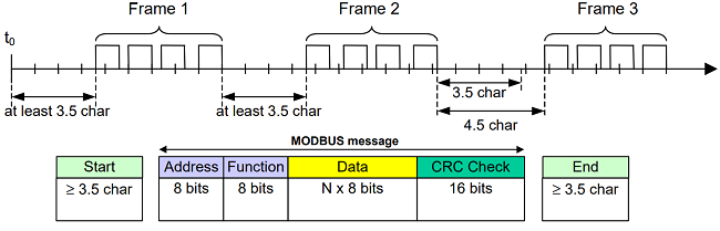

MODBUS RTU frame start and end with >=3.5 char interval i want to detect this interval using stm32 uart interrupt after detection of frame and i can process data further.
How can i detect this silent char interval using uart interrupt or any other way to do this?0690X000009jzROQAY.png

Some STM32 MCUs have UART peripherals with integrated idle timer. You could use that.
Or for MCUs without, start/restart a 3.5-character timer at each character reception. If it times out, it's probably a frame end.
