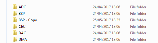

I wanted to copy \STM32Cube\Repository\STM32Cube_FW_F7_V1.7.0\Projects\STM32746G-Discovery\Examples\BSP project to an other place to keep the original intact, but I got a lot of errors. Cannot open a source file xxxx.yyy
I am using Keil.

Try to copy the project in the same place (folder) in order to keep the same path:

Posted on May 25, 2017 at 19:54
A good idea.
I looked at the project files, and they are a mess of xml code. Probably no use to try to edit paths there.
