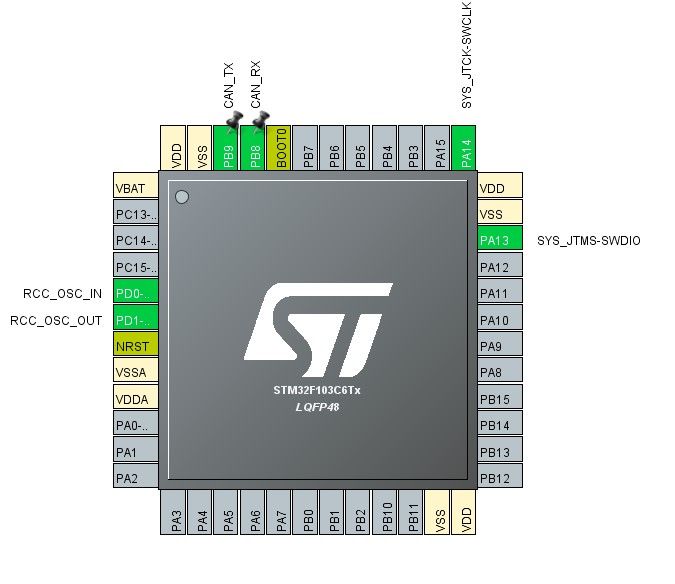

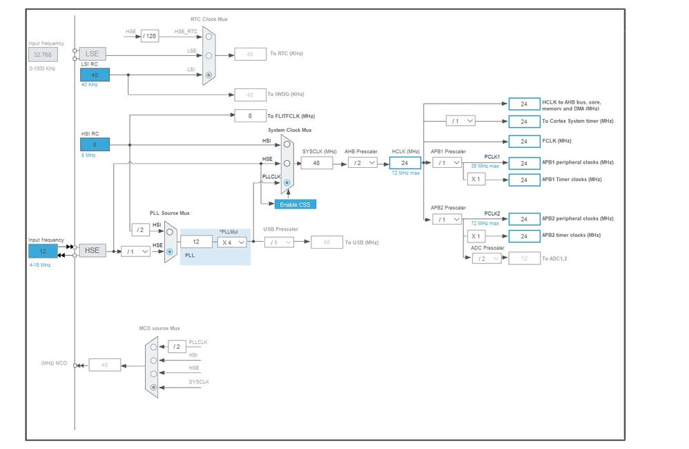

Hi everyone! I use the STM32F103 microcontroller to work with the CAN bus. I work in the Keil v5 environment and use the CMSIS library (I took the source files for my MCU from CubeMX). However, during debug, when I send the first data frame, I get the "Bit dominant Error" error in the CAN_ESR register. For verification, I created a project in CubeMX with the same settings and there I get an "Acknowledgment Error" error (this is a must because the module is not connected to the bus, but this at least means that it sends the frame). All register values ​​in my project (using CMSIS) and the project from CubeMX coincide except for the WKUI bit in the CAN_MSR register (it is not installed in my project, but it is installed in the CubeMX project). I think that in my project the CAN controller does not exit Sleep Mode since an invalid signal is on the Rx pin. However, I don’t understand why everything is normal in the CubeMX project, the values ​​of the registers are identical, maybe I'm missing something? Nzhe settings and sending packages in my project and project from CubeMX
Clocking:
Pin configuration

Clocking:
void RCC_Init(void){
	Clock_init RCC_ini;
	RCC_ini.Clock_source 					= PLLCLK;
	RCC_ini.PLLXTPRE 							= PLLXTPRE_Source_HSE;
	RCC_ini.PLLSRC 								= PLL_Source_HSE;
	RCC_ini.PLLMULL 							= PLL_4;
	RCC_ini.AHB_Prescaller 				= AHB_Prescaller_Div2;
	RCC_ini.APB1_Prescaller 			= APB1_Prescaller_Div1;
	RCC_ini.APB2_Prescaller 			= APB2_Prescaller_Div1;
	Clock_Friquency_init(&RCC_ini);
