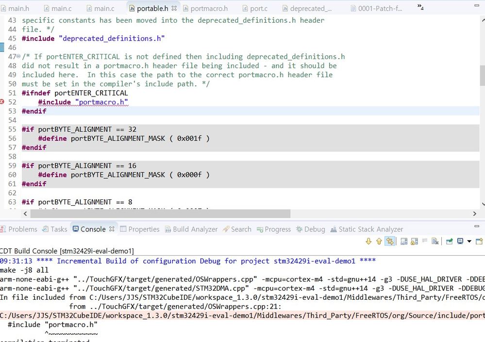

How can I fix that "fatal error: portmacro.h: No such file or directory"
pabian
1) I added portmacro.h in the folder
(\Middlewares\Third_Party\FreeRTOS\org\Source\portable\GCC\ARM_CM4F)

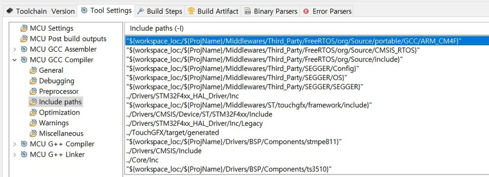

2) I added path for the header file (MCU GCC Compiler > Include paths)
1 REPLY 1

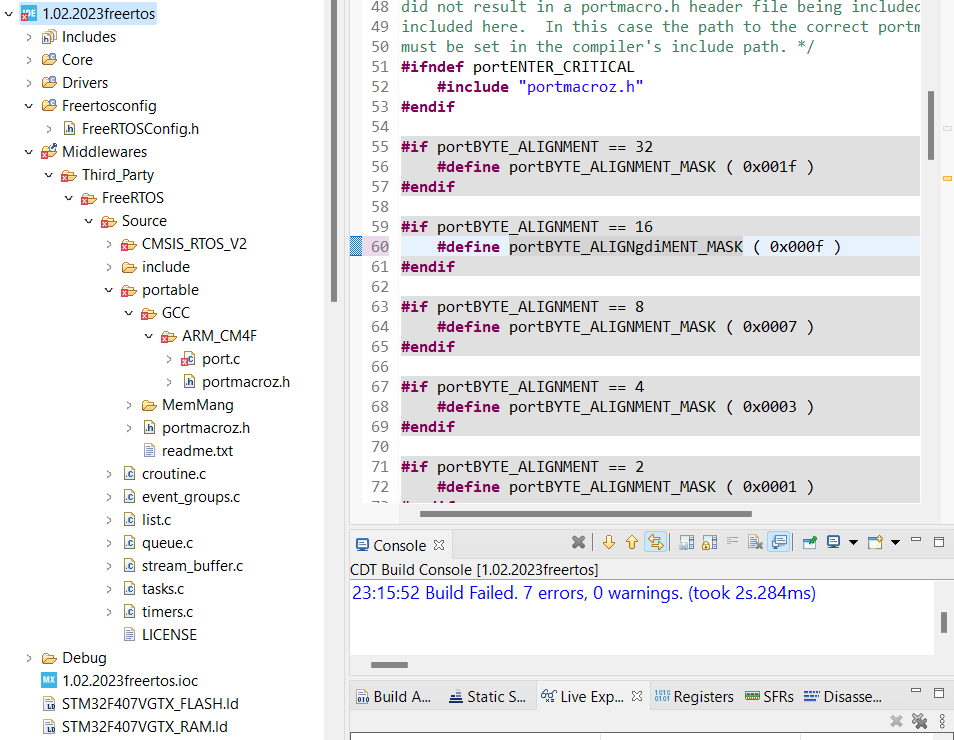

GOztu.1
I solved this problem by changing the file name, and copying the file to some other directory in this case i copied portmacroz.h file under portable.
