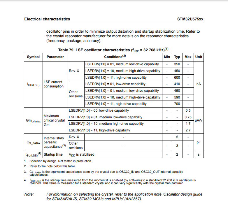

Hi..I am using STM32U575 NUCLEO ..there are three drive levels are mentioned for LSE...which one one should be used or which is more suitable for low power consumption and I need to know the power consumption in each case (numerical value)..

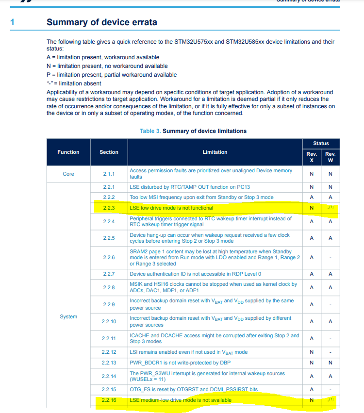

In the errata sheet,it is mentioned that low drive mode and medium low drive are not working.. but I checked and they work fine...is there any correction in the errata sheet...?..Can I go with low drive mode for LSE (NUCLEO-U575ZQ)???

It's depend on your microcontroleur revision.
If you have an Rev W , low drive mode and medium low drive are working. But if you are using a revision version older than this one, they don't work.

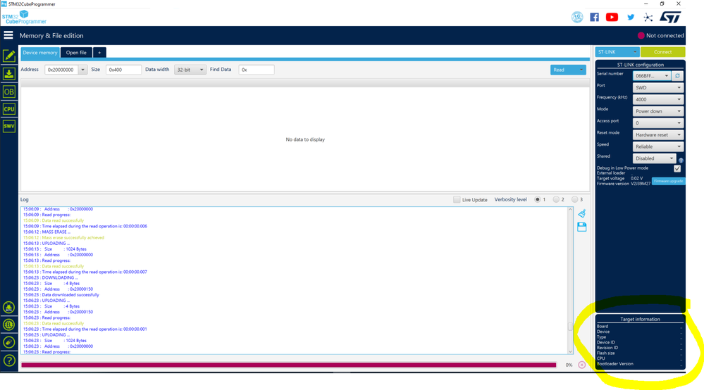

I think I am using Rev X (NUU575ZIQ$AT2)
You can check this information by using STM32C ubeProgrammer, in target information , you will find it .

i confirmed, It is Revision X.not W...but all modes are working....
Anyone can provide the power consumption details of each mode?
I had found those values for L4 boards...u5 boards have the same power consumption??

You can find the power consumption value of all levels in table 79 of the DS13737 of the STM32U575.

Hello @ABDUL​
it's possible that in certain case depend on your hardware workspace, it's working , just be sure that your LSE ready is set .
In revision version older than W, We do not guarantee the operation in these two modes because it depends on several parameters.
This issue has been fixed in the rev W.
