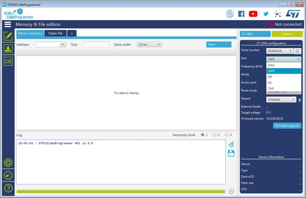

I would like to update my board firmware using bootloader CAN.
Could the STLINK-V3 allow me to flash my board using bootloader CAN ? otherwise, which kind of board should I use as a host PC ?

Actually I did not purchase one yet. I know I have to choose one with a bootloader CAN include like a STM32F412.
Is there a GUI who allow a drag & drop to flash the board, using CAN ?
I saw that STM32CubeProgrammer should be update to allow to flash the board using bootloader CAN but I don't know when.
If you have any other advice, it will be appreciated.

The Cube programmer offers CAN as a Mode for the ST-LINK connectivity.
As the creator of a CAN product why would you not have the ability to build both ends of the connection to implement your own tools?

My goal is to save time. Why couldn't I use fonctions that are implemented by ST ? like the bootloader and their soft ? They're here for that.
Then, I don't understand. If I use the CAN mode with a ST-LINK V3, I could flash my board through bootloader CAN using the "start programming" button, couldn't I ?
