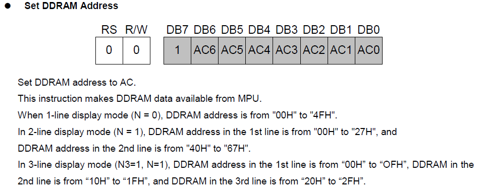

Oh alright Thank a lot for the help. Please tell me one last thing. If I have understood your drivers correctly, there is no function which will take me to a particular X,Y coordinate on the display, right?
‎2018-07-03 3:07 AM
You are right, there isn't (I am using a simple one-line display so just coded the ''home'' command) but you can easily add it coding the following command:
‎2018-07-03 3:18 AM
‎2018-07-03 3:58 AM
Watch out for the lousy implemented delay functions: they are 'calibrated' for a F103 running @72MHz.

‎2018-07-03 6:29 AM
I just changed that. It still isnt working. Were you able to spot anything else wrong.
