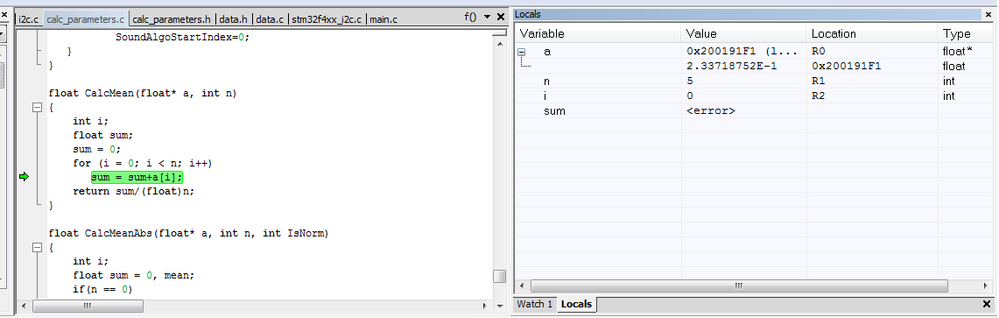

I'm using the STM32F4 on the discovery evaluation board.
I wrote a simple function that calculates the mean of a vector. When the code is starting to make the summation it goes to HardFault_Handler...
Here is the mean function, a moment before the exception:
When I hit F10, the code goes to void HardFault_Handler(void) at stm32f4xx_it.c.
Here is the call of the function:
SNR = CalcMean((float*)local_data_buffer.data_struct.handVISNRBuff,5);
Any Ideas?!
Thanks!
Yoav

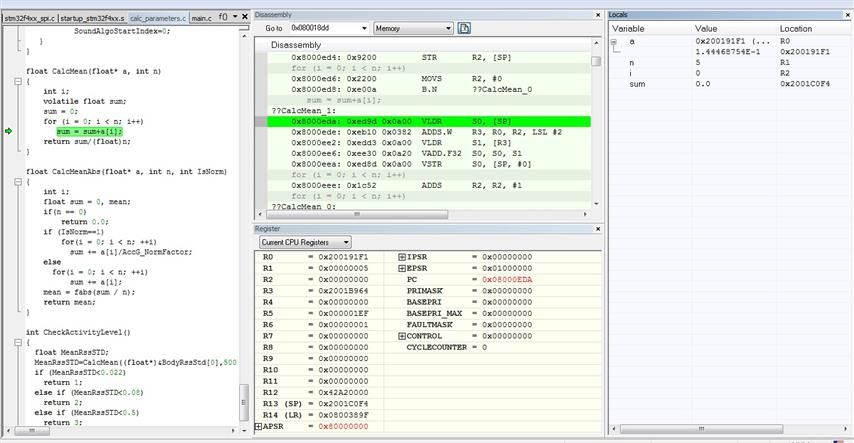

Posted on May 20, 2013 at 12:18
Hi again,
Attached is a print screen of the code, registers, locals, and assembly code.
When I hit F10 I get the hard fault exception.
I'll appreciate your help.
Thanks,
Yoav
Posted on May 20, 2013 at 16:58
Honestly it still looks to be a problem with the FPU.
Check SCB->CPACR
Check __FPU_PRESENT and __FPU_USED defines.
In main(), something like
