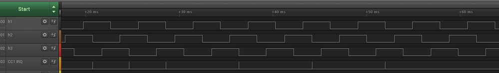

i am working on a bldc motor project for school, and for start to understand whats happening inside the IRQ handler, i have configured timer2  on ch1,2,3 with 3 emulated hardware signals, imitating the CW of a bldc motors
The hall emulated signals are coming from another development board. The signals are bellow
These signals ( H1,H2,H3) are feed into a STM32F407 device, on PA0, PA1 and PA2   which are Ch1,2,3 of the TIMER2
i have prepared only the initialization of the timer2 to see if the hall signals trigger the CC1 event in the irq handler, but its not triggering.
I've put a small toggle on a PC1 pin just to see when its triggering inside the TIM2_IRQhandler,
But there is no triggering,
At this point Timer1 is not initialized, i just want to see how it behaives on the hall signals.
I am missing something?  Of does the Timer2 takes some kind of feedback from TIM1 in order to trigger CC1 event?

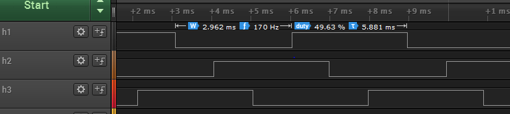

Ok, now that my IRQ handler is working,  i started the following code, i modifyied my timebase to overflow at arround 500 ms
My Hall signals each are 2.9 ms at 50% dutycycle.
Basicaly i have a hall event at every 1ms
The problem is that the CC1 interrupt should occour at every hall rising edge, is this correct?
But from the logic analyzer i see the CC1 is fired haoticaly,  and i wonder why....

Khouloud GARSI
Posted on January 13, 2017 at 18:58
Hi
Anton.Bogdan
Pleasetry with a basic configuration without using the filter :
TIM_ICInitStructure.TIM_ICFilter = 0;
And send me a new screen shot of the signals seen on the analyser.

Bogdan
Senior
Posted on January 25, 2017 at 22:31
In the end i solved'it,  it was because of the GPIO PullUP enabled for  the 6pwm outputs,  after configured with NOPULL everything is as expected.
Thanks guys
