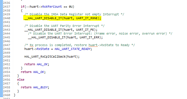

Posted on August 24, 2017 at 18:18
Hi
hos.sak
Sure!, when the UART IRQ handler is called it disable the Rx ITbefore the call of the callback interrupt function :
I suggest to you to declare a volatile globalvariable out of the main function, and change the value of this when the callback is called:
volatile uint8_t flag = 0;
void HAL_UART_RxCpltCallback(UART_HandleTypeDef *huart)
//Your code when receive the data
flag = 1;
and in the main:
if(flag)
//If you enter here the data have been received, so you must to call again the function
HAL_UART_Receive_IT(&huart1,ReceivedData,8);
flag=0; //Clear the flag
So the receive function is just called when some data have been received and the interruption have been disabled.
