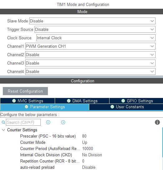

I've got the same issue with the PWM channel mode... I'm not able to create a PWM faster than 100khz...

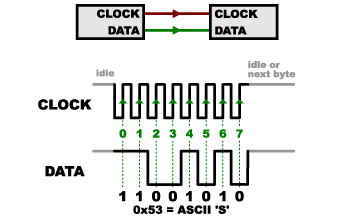

I need to create a sort of SPI without having even byte alignment...
The final speed must be 158khz, i need to toggle the data pin before the rising edge of clock.
_legacyfs_online_stmicro_images_0693W00000bjBQNQA2.pngSomething similar to this... using synch serial hardware module, it generate the data not usefull during transmission.
I2C Module hardware protocol coded inside... Any tips?
