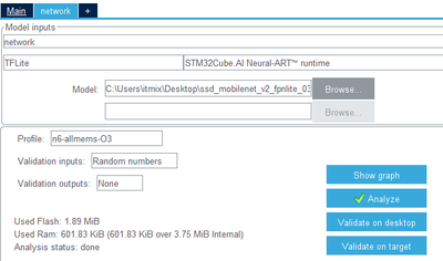

In .ioc → Middleware → X-Cube-AI → Configuration → Network,
make sure that Analyze is enabled.
If it’s not enabled, please re-import the AI model and enable it.

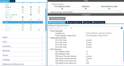

After re-importing the AI model, the clock settings may change.
Go to RCC → Power Regulator and set it to 0.
Once all these settings are complete, delete the NPU file that was imported into the Appli project, and then re-import it.
If all the above steps have been completed, please try uploading Network.hex to the board again.
