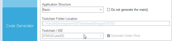

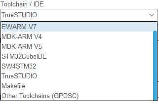

So, as far I understand you have generated your project with the help of CubeMx with your custom peripheral initialization. Is it?
Have you generated makefile base project? If yes, then it should be work without any problem.
As above image there is a option for CubeIDE so why you need to converting project?
2019-08-05 3:19 AM
Hello @Community member
By now CubeIDE generates the project in according with my peripheral definitions.
CubeIDE integrates CubeMx and Truestudio,
Yacob Hassidim.
2019-08-05 3:28 AM
Hello @Community member You are not answering my queries in proper way. Now, I am confusing what you trying to say.
As of my understanding, I given you the different way you can build you project. If you require any kind of support then tell me.
2019-08-05 3:53 AM
Thank you very much for your support.
I am sorry that I confused you with "converting from IAR".
I started with CubeMx (for configuring of peripherals and code generation) and IAR (for IDE) and now I use CubeIDE.
CubeMx has the multi options of Toolchains.
CubeIDE has only one Toolchain/IDE option: STM32CubeIDE (see following figure).
May be I didn't understand you about "different way to build project".
Can you please explain again?
Yacob Hassidim.
