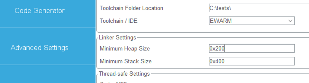

Actually, most toolchains set a default value of zero for the heap size. Many embedded projects do not use dynamic memory allocation at all.
To modify thus value , you can check :

Hi, thanks! I did check already this Project Manager window and saw these values.
Now, 0x200 and 0x400 are not much, so I am interested about the maximal values, as these are Minimum Heap/Stack Sizes.
