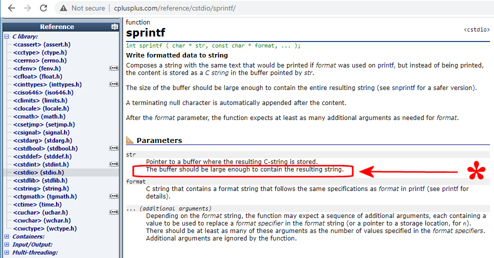

Friends, I want to send a float number with uart. But it sends wrong, what should I do?

	  sprintf(value, "%f",x);
	  HAL_UART_Transmit(&huart1, (uint8_t*)value,strlen(value),HAL_MAX_DELAY);

4 REPLIES 4
MM..1
Chief III
Primary error is sprintf(value, "%f",x); and too value[6]
you need format and one more byte for zero string end, plus include string...
So it should be 7, not 6. Can you explain the problem in sptint a little more?
I mean you use any float not only this and place breakpoint after sprintf and check string
"Can you explain the problem in sptint a little more?"
sprintf() is a standard C library function - you can find details about it in any C reference; eg,
http://www.cplusplus.com/reference/cstdio/sprintf/
