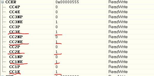

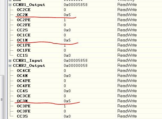

I'm currently using an STM32F413 and I would like to use the forced output mode on the TIM1 with 3 PWM already configured.
I followed the instructions noted in the reference manual [17.3.7] :
- CCxS bit to 00 in the TIMx_CCMRx
- write 101 in the OCxM  bits
But I still can not force the state of my output pins.
Here is my code :

I checked in debug mode that the registers are affected and yet I do not have the desired levels output.
Any idea ?
Thanks in advance !

    henry.dick
    March 19, 2018
    Posted on March 19, 2018 at 18:23
    Set the pin to the right alternate mode.
