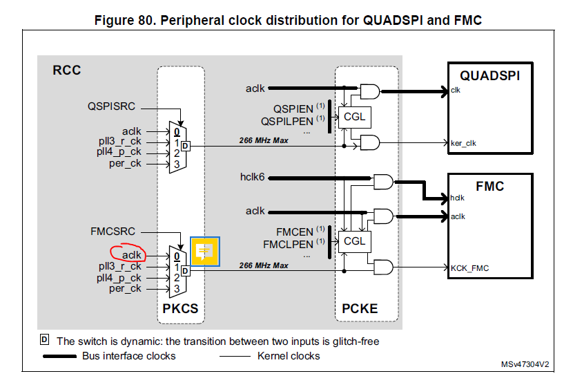

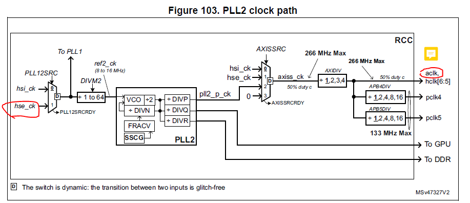

Working with this document:
https://www.st.com/resource/en/reference_manual/DM00327659-.pdf#page=709&zoom=100,89,117
I'm thinking to feed the FMC peripheral with "aclk"
The "aclk" will be generated from a 43.75 MHz clock through the HSE pin that will be connected to the device's HSE pin and driven with an external oscillator clocking at 43.75 MHz (The frequencies of HSE and "aclk".will be the same)
Will this work ?
