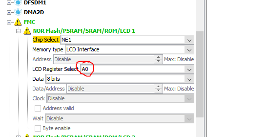

I am trying to configure STM32L4 with an 8-bit monochrome LCD using FMC using CubeMx Tool. I have configured the timing parameters. I could see that the LCD Command and Data are to be written in a particular address location. How is this derived?

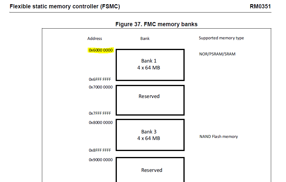

When you choose the Bank 1 for LCD interface the highlited address is the base address.
At ''LCD Register Select'' field you choose an address bit that is connected to an external pin also.(connected to command/data pin on your LCD)
For this example we use BANK1 PSRAM1 and A0 as LCD reg select bit

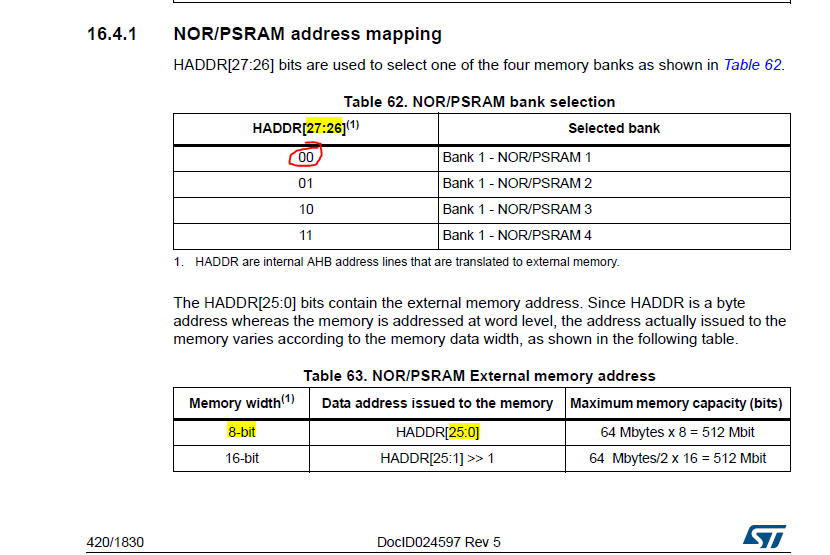

The Address for data access, can be 0x60000000 (or generaly 0b0000yyxxxxxxxxxxxxxxxxxxxxxxxxx0 in binary form). The address for register(command) access can be 0x60000001 (or generaly 0b0000yyxxxxxxxxxxxxxxxxxxxxxxxxx1 in binary form)
Another example is BANK1 PSRAM1 and A16 as LCD reg select bit
The Address for data access, can be 0x60000000 (or generaly 0b0000yyxxxxxxxxx0xxxxxxxxxxxxxxxx in binary form). The address for register(command) access can be 0x60010000 (or generaly 0b0000yyxxxxxxxxx1xxxxxxxxxxxxxxxx in binary form)
x ->can be 0 or 1
yy is the bank 1 PSRAM 1 or 2 or 3 or 4 according to table 62

But, Is the LCD Register select bit(Ax) is the only criteria for the Address?.. Because, I am using 2 variants of LCD. STM32F3 with 16-bit TFT display and STM32L4 with 8-bit Monochrome display. In the TFT case, I am using A16 as register select with Bank 1. So, expecting the address to be 0x60010000, but it works only with 0x60020000. But, in Monochrome case, I am using A18 as register select and the address 0x60040000 works fine as expected.
‎2017-09-21 2:29 AM
Hi
>>>''But, Is the LCD Register select bit(Ax) is the only criteria for the Address?.''
For LCDs that have one pin for selecting between Data and Register (or Data and Command), named CD, RS, whatever, yes is the only criterion.

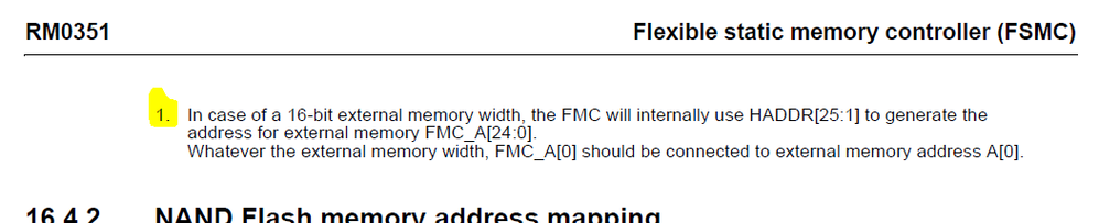

>>>''expecting the address to be 0x60010000, but it works only with 0x60020000''
My above post concerns 8bit wide FMC
I didn't write for 16 bit access.
16 bit access uses for addressing bits 25:1 not 25:0 so it is normal to have command address 0x60020000. It is writen in remarks of table 63.
