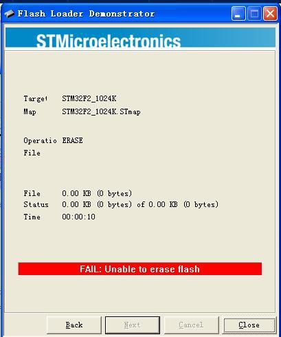

Flash Loader Demo unable to erase stm32f207vg
Options
‎2014-02-26 2:08 AM
Posted on February 26, 2014 at 11:08When i use the flash demo to erase my mcu, i selected erase all and click Next, flash demo tell me ''FAIL: Unable to erase flash''.What's wrong? Where can I get more information about it?thanks.

Hi Gao Si,
I think you need to be a little more specific. It is hard to help with only this little information. What board are you using? exactly what tools do you flash with? etc.Regards,/rygelxviOptions
‎2014-02-26 7:38 AM
Posted on February 26, 2014 at 16:38
I suspect that's the OP's POINT. I would look at what options and write protect settings have been applied to the part. Consider using the ST-LINK utilities? Or what you might have done to the part prior to this issue. Connect using 9600 8E1 (Even Parity) Try using the command line version, it might provide additional information.
