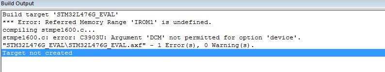

    ps: one more thing is, when we compile the project for Xcube IAP, we got a compile error. We didn't do any changes, can you also please guide us for what we did wrong?
