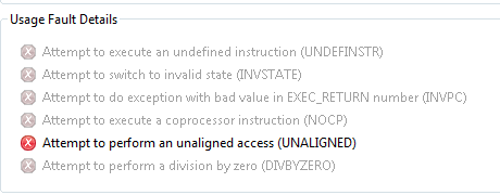

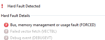

The code successfully arrives at the app location and begins to run the startup code. However, something causes a hard fault in/around the subsequent startup (_stm32f765xx.s) code   bl __libc_init_array. I have stepped through the code and it appears that the processor is skipping over this array initialization. The TrueStudio Fault Analyzer says:
This seems to have something to do with data alignment, but I have no clue where. I have seen other threads that talk about DFU data alignment issues. But I am not using DFU. I am simply programming the image directly to flash. The size of the binary image that gets flashed is 0x2B1EF, so I pass the size value of 0x2B1F0 to the flasher in the bootloader hoping that it may avoid some sort of data alignment/boundary issue with the flasher. to no avail.

    Make sure the Boot Loader side initialization doesn't trash the data you are going to Flash. ie Zeroing statics, stack, etc
    I'm presuming the data is in RAM, not to a secondary FLASH area.
    When I do a reboot with constants in RAM it is to code that I have in the Reset_Handler, not C code deeper in.
    Do a CRC or checksum of the Application FLASH image, compare with the PC side computed value, I package app firmware with a CRC so the loader can check it for validity before calling, this way a broken image doesn't brick the device.
    You could also try reading back the current data using ST-LINK Utilities and compare against the valid/working image.
    Check the SP/PC values being seen by the loader.
    This is where the problem was. My radio does a CRC on each received packet so that my code doesn't need to, but my code had an error in the packet counter. So every 50th byte in the RAM image had a 2 byte gap. UGH! Fixing this makes everything work beautifully!
