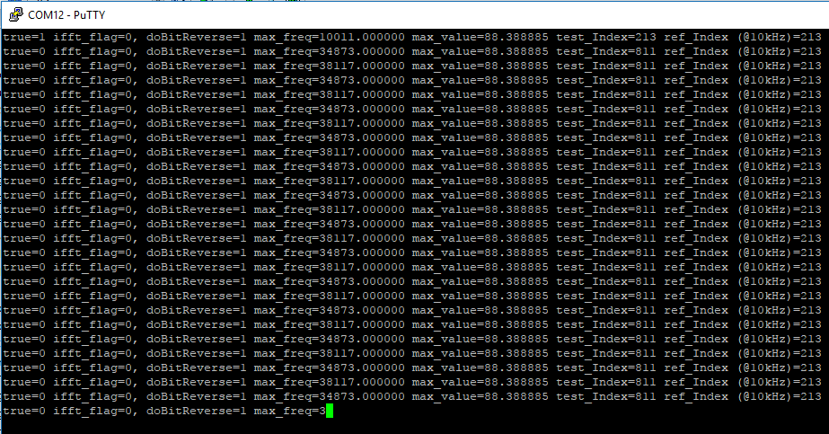

Hi folks;
I want to use fft (1024) in my signal which came from i2s, so it's should be real time. I'm new at fft, there may be some mistakes. And sorry for my bad english
When i use fft without loop everything works fine;
void main(){
arm_cfft_f32(&CFFT_LENGTH,wave_buffer,ifft_Flag,doBitReverse);
arm_cmplx_mag_f32(wave_buffer,fft_Output,fft_Size);
arm_max_f32(fft_Output,fft_Size,&MaxValue,&testIndex);�?�?�?
while(1){
But in loop, ihave a trouble, as in the picture;
*memcpy for refresh buffer or new data inputs
void main(){
while(1){
memcpy(&wave_buffer,&wave_Input,2048);
I solved this problem but i had new one. First value isright, others isn't.
void main(){
while(1){
counter++;
if(counter%2==0){
memcpy(&wave_buffer,&wave_Input,SAMPLES);
max_freq=(48800/1024)*testIndex;
else{
memcpy(&wave_buffer,&wave_3_440Hz_44100,SAMPLES);
max_freq=(44100/1024)*testIndex;

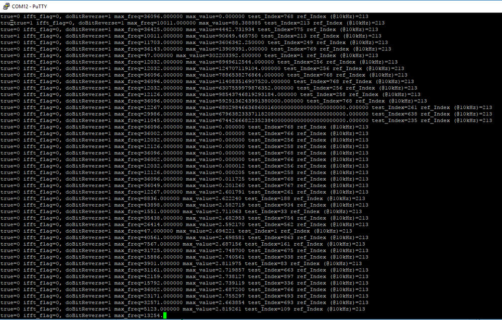

Question-1: Why
frequency
valueschanged unexpectedly? (terminal picture-1)Question-2: Why frequency values isn't equals reference values? (terminal picture-2)
