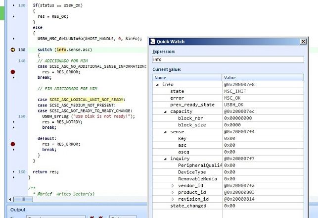

I went deeper in the code trying to find where the error is being generated and I reached the following:

If you look a little deeper, in the function called to obtain the error source  (USBH_MSC_GetLUNInfo());

In fact, the variable used in the switch have the value 0x00, which is:
#define SCSI_ASC_NO_ADDITIONAL_SENSE_INFORMATION         0x00
#define SCSI_ASC_LOGICAL_UNIT_NOT_READY                  0x04
#define SCSI_ASC_INVALID_FIELD_IN_CDB                    0x24
#define SCSI_ASC_WRITE_PROTECTED                         0x27
#define SCSI_ASC_FORMAT_ERROR                            0x31
#define SCSI_ASC_INVALID_COMMAND_OPERATION_CODE          0x20
#define SCSI_ASC_NOT_READY_TO_READY_CHANGE               0x28
#define SCSI_ASC_MEDIUM_NOT_PRESENT                      0x3A
