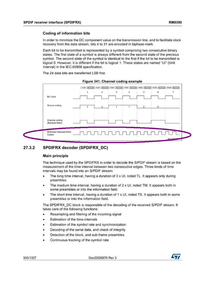

['F446 documentation] SPDIF-Rx - funny waveform in Fig.
waclawek.jan
Posted on January 25, 2018 at 22:08
It's a clock, twice as fast as bitclock, and not Bitstream Biphase-Mark Coded.
