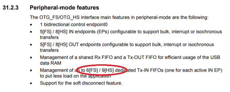

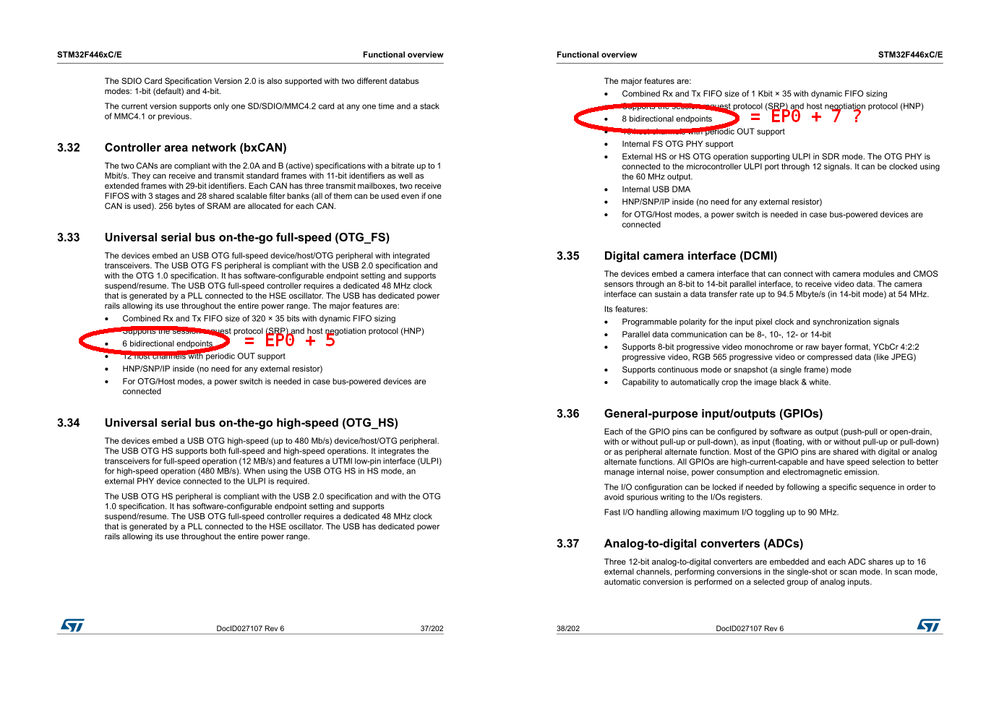

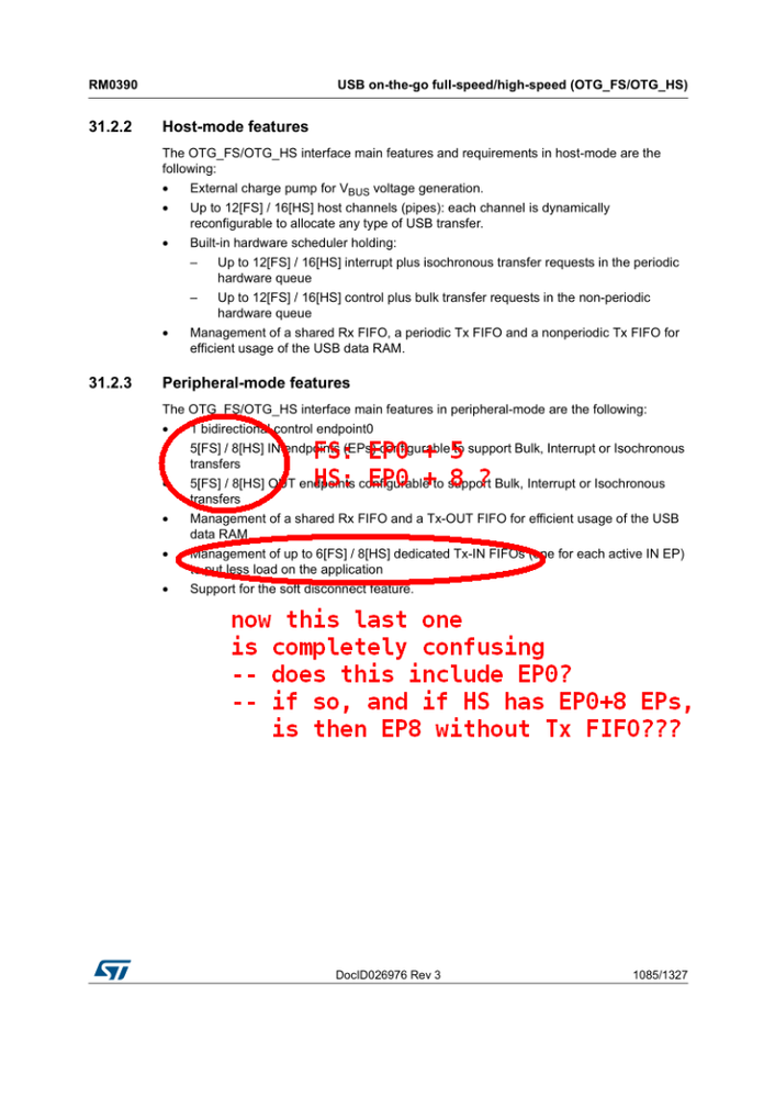

['F446 documentation] How many endpoints has OTG_HS?
waclawek.jan
Posted on February 12, 2018 at 23:10

Hello Jan,
Number of endpoints: 6[FS] / 9[HS]
-> 5[FS] / 8[HS] device endpoints + 1 bidirectional control endpoint0
This was fixed on
http://www.st.com/content/ccc/resource/technical/document/reference_manual/4d/ed/bc/89/b5/70/40/dc/DM00135183.pdf/files/DM00135183.pdf/jcr:content/translations/en.DM00135183.pdf
Thanks for your feedback.
Khouloud.
Posted on March 21, 2018 at 20:03
Hi Khouloud,
In [STM32Cube_FW_F4_V1.21.0]\Drivers\CMSIS\Device\ST\STM32F4xx\Include\stm32f446xx.h :
♯ define USB_OTG_FS_MAX_IN_ENDPOINTS , , , , , , , , , , , , , , , , , , , 5U , , , /* Including EP0 */
♯ define USB_OTG_FS_MAX_OUT_ENDPOINTS , , , , , , , , , , , , , , , , , , 5U , , , /* Including EP0 */
♯ define USB_OTG_HS_MAX_IN_ENDPOINTS , , , , , , , , , , , , , , , , , , , 8U , , , /* Including EP0 */
♯ define USB_OTG_HS_MAX_OUT_ENDPOINTS , , , , , , , , , , , , , , , , , , 8U , , , /* Including EP0 */
is still wrong.
I'd say the same applies for HS in 'F469/'F479 (I've seen RM386 being fixed in this regard, I assume the related datasheets are flagged already).
Jan
Posted on March 29, 2018 at 12:57
Hi Jan,
This point is also internally reported and will be fixed soon.
Khouloud.
