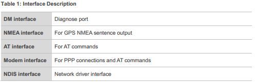

0690X00000ArgV7QAJ.jpgI started off by using the STM cube generated libraries.Reviewing modem's documentation, i assumed that it will be just a CDC device with a few minor changes. I asked Quectel for device descriptor, they sent me one for EC21/EC25 which is similar to BG96.
According to the doc, EC21/EC25 creates five interfaces. (image) i verified it after reading complete device descriptor for BG96. (attached)

Now, i think to get it to work, i would need to write a class for composite device. I have scavenged the Internets for anything useful, while also experimenting with the CDC class.
i have found a couple of things as
  1. USBH_Process is written in such a way that it will only support a single interface. and that ''case HOST_CHECK_CLASS:'',''case HOST_CLASS_REQUEST:'', and ''case HOST_CLASS:'' should be modified so that these cases do their job for each interface.
for example from Case HOST_CHECK_CLASS:
if(phost->pClass[idx]->ClassCode == phost->device.CfgDesc.Itf_Desc[0].bInterfaceClass)
2. Piggybacking over CDC class would be impossible(or i would have to rewrite most of the code, as there are multiple checks within the class's methods(find_interface etc ) to have 0xFF (vendor specific) declared as no valid interface.
The good thing is almost all the endpoints are described as BULK in EC21, so im guessing i would only need one CDC class.
So, For in order to get it to work, i would need to modify usbh_process as well as the entire CDC class.
Am i going in the right direction?
Anyone knows anything about how it can be or should be done?
would i need to know specific codes? there are lot of defines in usbh_cdc.h, would they work? BG96 uses Qualcomms MDM 9206. do they use different codes to get things done?
Any help would be appreciated.
1 REPLY 1
Danish1
Lead III
I tried and failed with Telit modems. I think they used Qualcomm's proprietary QMI protocol and the Quectel might be similar. That's not to say you won't succeed but might need better insight or luck than I had.
If you're familiar with Linux drivers, you might get better insight by looking at gobinet or qmi_wwan.
