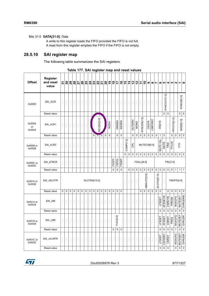

['F446 documentation and SVD] Misnamed MCKDIV
waclawek.jan
Posted on January 24, 2018 at 21:07
Should be MCKDIV.
Also, the same typo is in the relevant .svd files, making thus MCJDIV appear as xCR1 bitfield name in debuggers (spotted in
https://community.st.com/thread/46652-f446-documentation-saispdif-tx-bit-clock-formula-missing?sr=inbox

Imen.D
Posted on March 02, 2018 at 11:31
Correct name
MC
K
DIV
added
in the new RM0390 Rev 4, and it will be updated for other impacted reference manuals.

Imen.D
Posted on January 30, 2018 at 14:05
Hi
Waclawek.Jan
Thank you for all your reported issues.
I will raise internally this typo for fix in the coming releases.
Best Regards
Imen

Imen.D
Correct name
MC
K
DIV
added
Kind Regards,
Imen
Thanks
Imen
Posted on March 02, 2018 at 22:18
And the SVD files?
Posted on March 04, 2018 at 22:18
Hello
Waclawek.Jan
The issue about the SVD files is already passedinternally to the appropriate team for fix.
Kind Regards,
Imen
