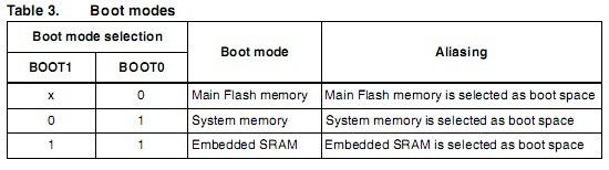

i try to get the board into BOOT mode,was my steps wrong?
1 remove R26, then 10 KOhm pull-up resistor  to solder
R27
2 fit the SB14  SB15,  then press 'download'button,but the same wrong
what should i do next(i using keil MDK 453)?

i download a F0 DISCOVERY user manual(UM1525),it seem very simple,no describe about how to enter BOOT

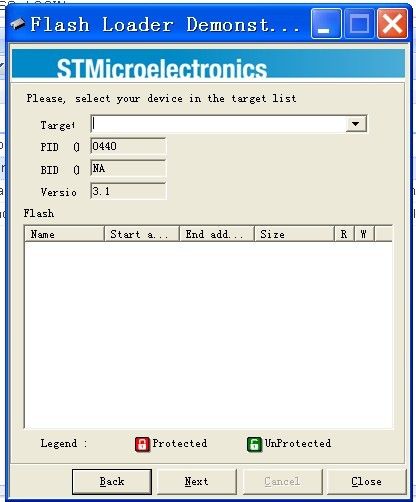

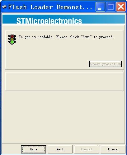

now the F0 DISCOVERY can enter the BOOT0 MODE, I download the UART tool ' Flash_Loader_Demonstrator_v2.5.0', it can read the IC  ,but it seem can't support  it
lbheibai
Posted on August 08, 2012 at 09:36
the 'flash_loader2.5' is the newest version i can download from the website
tdowad
Posted on August 28, 2012 at 02:47
What did you do to get it into Boot mode?
Remove R26, add R27, add SB15 and SB14...anything else?
