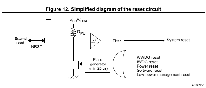

I've an Nucleo-f091rc, and i need using this board to programming an external STM32F070, using SWDIO, I've connected SWDIO, SWDCLK, NRST and GND. My external MCU have external 3.3V. When I try to connect I receive the mesage No target connected.

As Clive said,  take a quick look on this pic.
Maybe re-check your VDDA/VDD pin and NRST Pin with a oscilloscope.
(I've got a wired L053 Nucleo Board, the st-link keeping resetting the target MCU every few hundred msec, after update the firmware of st-link this resetting action disappeared somehow.)

Sorry All.
I'm using the wrong pins to connect the MCU to my pcb board.
Pin 1 is the smaller, concave mark in the lower-left, and I'm using the pin 1 on
larger mark in the upper-right.
Anyway my external MCU works  fine now.
