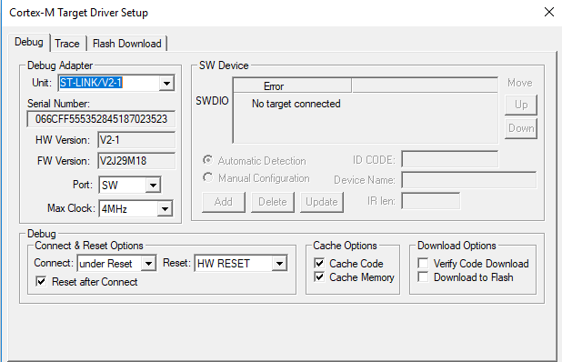

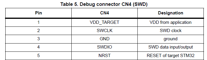

I've an Nucleo-f091rc, and i need using this board to programming an external STM32F070, using SWDIO, I've connected SWDIO, SWDCLK, NRST and GND. My external MCU have external 3.3V. When I try to connect I receive the mesage No target connected.

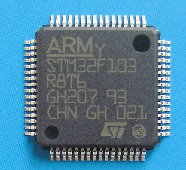

Pin 1 is the smaller, concave mark in the lower-left, and I'm using the pin 1 on
larger mark in the upper-right.
Anyway my external MCU works fine now.

The Nucleo user manuals use to have a section about debugging external targets, did you follow it ?

If you have removed the jumpers on the Nucleo then the next most probable cause is the target isn't correctly powered.
Check VDDA connection
Check part orientation
Check NRST state

I'm try using Keil to debug

I have removed CN2 jumpers.

Reset 0V.
how can it be Reset Pin is 0V?!?! Something is pulling down this pin on your board?!
‎2017-12-21 6:56 PM
The STM32 can clamp it low, usually indicative of the power supply pins, or orientation issues.
