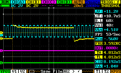

What exactly I wanto to make is to connect RFID Frond-End chip EM4095 with STM32. I am using two outputs of EM4095, RDY/CLK and DEMOD_OUT. I have a small osciloscope (DSO QUAD) and I upload the scope picture.
EM4095 outputs a square wave on RDY/CLK pin at 125 KHz as expected. If there is no RFID tag in front of the coil, it gives a square wave on DEMOD_OUT pin at ~3.600 KHz. I am using EXTI interrupts for that input and I want to count the RDY/CLK cycles until next rising edge of DEMOD_OUT, therefore I configured the TIM3 so that it will count up on each rising edge of RDY/CLK signal.
As you can see on the picture below, the TIM3 shall give 31 or 32 until next interrupt, but it gives always 0 or 1. Blue line is RDY/CLK, yellow is DEMOD_OUT.

Posted on March 24, 2014 at 23:54
If you must reset the timer's counter, then do it BEFORE outputting to the LCD, which is likely very slow.
Alternatively don't reset the counter, just remember the previous value and compute a delta (b-a) of how it changed.
