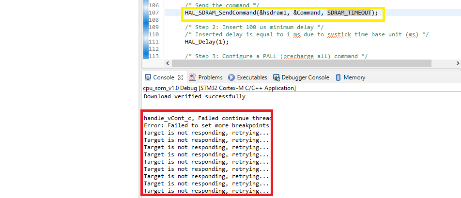

I have connected external 16Mb SDRAM with STM32F429ZI controller.
While initialization sequence of the SDRAM i am getting following error:
handle_vCont_c, Failed continue thread
Error: Failed to set more breakpoints
Target is not responding, retrying...
While debugging I checked this is happening when code is at following point:
 HAL_SDRAM_SendCommand(&hsdram1, &Command, SDRAM_TIMEOUT);
I am attaching the screenshot of exact problem.
Following is my MX_FMC_Init & BSP_SDRAM_Initialization_sequence:

0693W000008vv2kQAA.pngPlease give the solution.

You'll probably have to work to a solution.
Check you aren't breaking the debugger connection via pin configurations or low power modes.
Instrument your system so you can get secondary diagnostics out a serial port, irrespective of the debugger connection.
Have Hard Fault and Error Handler routines output actionable information.
Use better tools..

Hi Tesla,
Thanks for you immediate response.
I checked the debugger connection is not breaking.
Actually while debugging the step by step its working when I go into that particular HAL_SDRAM_SendComand step then this error generate.
Please check the configuration code of SDRAM. Is it correct?
