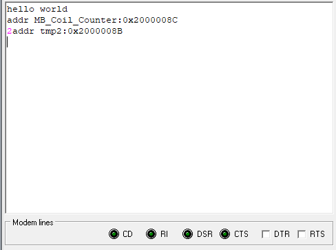

error description:
I wrote a function to change the UART parameter! After using this function, the UART parameter worked as installed but when the data was sent, the UART interrupt function changed a global variable of I am back to 0!

How large is the stack? Does the problem change if you define your local/auto variables as static?

0690X000008BA1xQAG.pnghi!the stack size is 128byte!I used debug for printf address of variable!the address of tmp( variable in interrupt UART function) include address of MB_COIL(global Variable)
