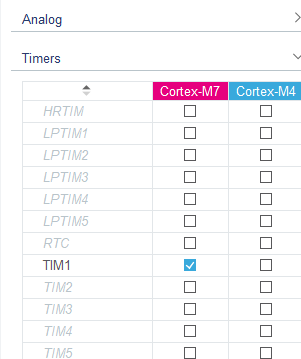

You need to enable/assign it to CM7 in Timers tab before:
