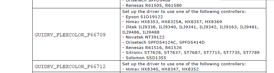

i work on emwin library. in first hello world project
stm32cubef1\STM32Cube_FW_F1_V1.2.0\Projects\STM3210C_EVAL\Applications\STemWin\STemWin_HelloWorld
my code is :
HAL_Init();
SystemClock_Config();
BSP_Config();
GUI_Init();
WM_SetCreateFlags(WM_CF_MEMDEV);
MainTask();
while(1)
and in
MainTask()  my code is :
GUI_Clear();
GUI_SetFont(&GUI_Font20_1);
GUI_SetColor(GUI_RED);
GUI_DispString('Hello world!');
but nothing is display on lcd. my lcd controller is ILI9341 . i changed the lcd initialization code and i test. that is ok.
but I dont know What is Wrong....
how can i link the emwin to my lcd code ?
Please help me ...

HIthank you for responsei send to you my project.please check my codei dont know what is wrong...thank you.

Posted on October 03, 2017 at 16:15
Hello!
Just after a raw investigation , found that you are not use the correct driver for your LCD. Inside LCDConf_stm32l10e_eval.c the GUIDRV_FLEXCOLOR_F66712 is for other LCD module.
For ILI9341 use  GUIDRV_FLEXCOLOR_F66709
Also STemWin, CubeMx, firmware libraries  are not updated to latest version.
Regards.
