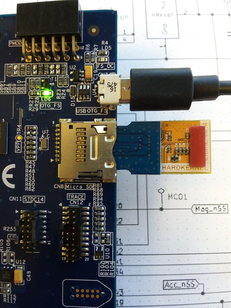

Hours of fun to be had there.. My approach was to use the ODROID eMMC modules, will also plug directly into an assortment of EVAL and DISCO series boards. Have 4 thru 128 GB working.
People have made direct dongles, but soldering eMMC BGA's is a pain. For raw devices consider clam-shell sockets.

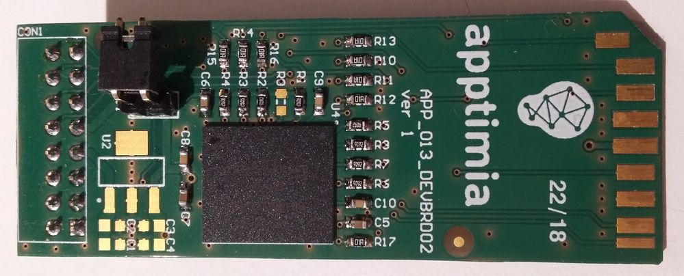

@Community member​ fabbed some SD card sockets (hats) that plug into the the Nucleo-144 header
‎2019-11-27 9:38 AM
The ODROID was my most portable/flexible method
@Community member​ made an eMMC dongle, worked as either an SD card or top/bottom of Nucleo-144 depending on socket/headering attached.
I used a 16-pin socket so I can rear mount it and not foul the shield socket.
I'd probably buy a clam-shell socket and wire that if doing more work on them, or a customer specific IC needed testing.
‎2019-11-27 9:52 AM
OK, I'm convinced by the ODROID solution.
The Lukaszs' custom board is nice, but it would take too much time to do so!
