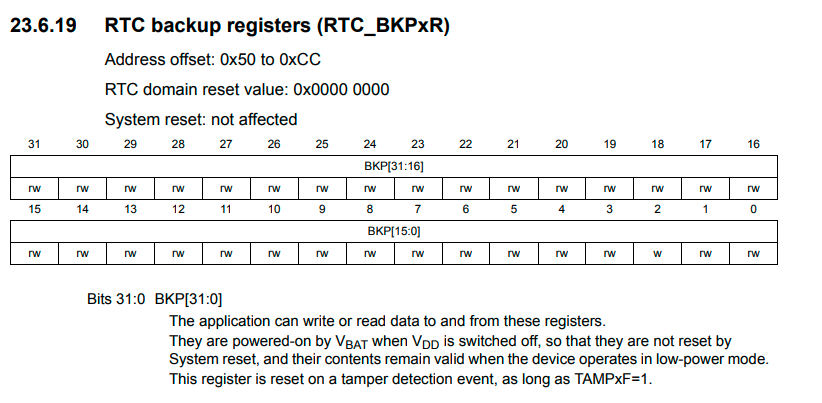

I have a STM32F373VBTx serie. I know that the RTC saves the backup registers for every second. But when I restart my STM32, then the RTC sets to default date and time again due to the MX_RTC_INIT() function who is generated by CubeMX.
I have two questions:
  1. Does the RTC run, even if Vdd = 0 and Vbat = 3 volt?
  2. If 1 is YES: How can I make sure so I don't run MX_RTC_INIT() at start up if Vbat have a voltage source?

1 yes
2 in the user code section at the start of MX_RTC_INIT, check to see if it's initialized and if so, return from the function.

So what can I do with the backup registers?
Edit:
Or do you mean like this?
static void MX_RTC_Init(void)
  /* USER CODE BEGIN RTC_Init 0 */
	if(hrtc != NULL)
		return;
  /* USER CODE END RTC_Init 0 */
