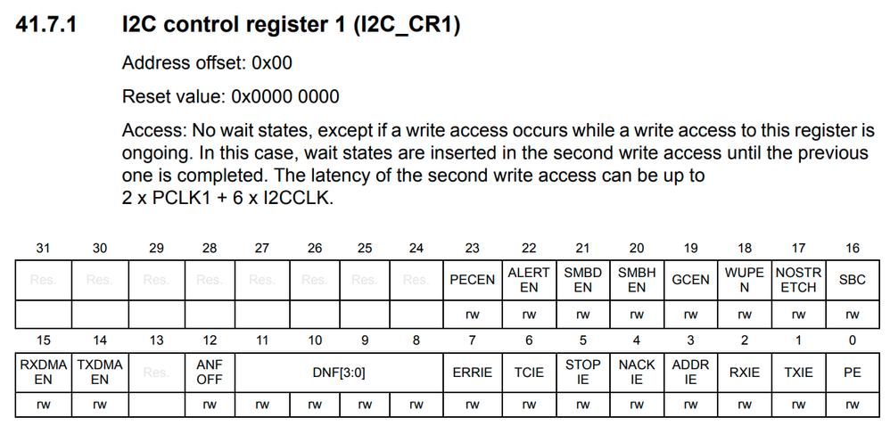

Does stm32g473 support multiple concurrent I2C ports? uC has 4 I2C devices mux'd to unique port pins but appears to have only 1 ISR register for all. This application both I2C devices are slaves and may be accessed concurrently.

Thanks for your reply. I had previously seen the registers listed in RM0440 section 41.7.7 representing an example instance of the I2C registers and no mention of concurrent usage of these devices.
But, after your response I found Table 3. STM32G4 Series memory map and peripheral register boundary addresses that shows 1k byte for each device instance. So I agree - control and ISR/data registers are available per peripheral instance.
Small amount of additional reading in my future.

I'd expect each I2Cx instance to have it's own set of registers and related handlers.
RM typically describes the register bank for a single instance, that is stepped-and-repeated, it's not an 8051 where every register in the design is re-described for each instance.

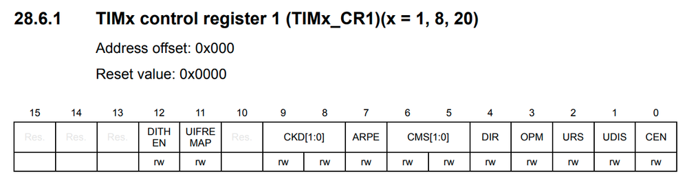

It is inconsistent in the RM that sometimes registers have an "x" in them to denote that they are per-peripheral or per-channel or per-whatever, while other times they do not.
Timer registers are TIMx_*** in the manual:
While I2C registers are not:
I can see that being confusing. After looking at RMs enough you just gloss over that part of it. Not saying it shouldn't be improved.
