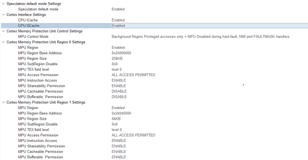

1. I have modified the STMxxx_Flash.ld  linker file by adding some memory sections. Does the sequence of SECTIONS definition matters? LinkerScript.ld and MPU Config Added.
Layout:
ITCM -> Has some functions
DTCM-> non DMA Global Variables
D1 RAM (First 256KB)-> DMA Buffers with Cacheable and Bufferable Disabled in MPU Region
D1 RAM(Last 64KB)-> Data benefitted from caching with Cacheable and Bufferable Enabled in MPU Region
2. Vector Table and ITCM have the same start address (0x0000 0000). I have to do anything or its handled already?
3. Did i modified the heap-stack section correctly for it to work from DTCM.

3 REPLIES 3
Order matters in processing the linker script as it is processed in a linear fashion.
It's also necessary to add code in startup.s to initialize things properly, move data around and clear things.
Better implementations create tables the startup code can process/unpack more automatically. Look at how Arduino manages this with the GNU tools.
You'd want to a) review the .MAP to see what the linker is up to and b) review the .ELF to understand what the linker built. Check tools like OBJCOPY and OBJDUMP to confirm/validate what's going on.
I modified the startup file. I will check Arduino implementation. But, what I have no starting point how the sequencing of SECTIONS should be.
Linker scatters each input object file (for example main.o) to sections (text, data etc.) then scans the link script to find the target section of each source section. The first match wins. This is why the order of sections and filters in the link script is important. Most specific filters (that contain exact section name) should go first.
