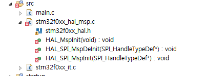

Can you tell me HAL_MspInit(void) function belongs to which STM device ?
Doesnt  it belongs to
stm32f7xx?
I have srearch in this document, but didnt find
stm32f7xx?
No.
It is shown as an element of
stm32f0xx_hal_msp.c
, thus is a function implemented in this file.
Those tree elements are basically Eclipse -standard, and look alike in most Eclipse-based IDEs.
Perhaps your question contains a spelling mistake, and you meant
stm32f
0
7x. In this case, the answer would be yes.
ST had been pretty consistent in this naming.
stm32fxxx
would include all F devices,
stm32f0xx
all F0 devices (e.g. F03x, F05x, F07x, ...) and
stm32f07x
all F07 family devices.
The STM32F7 is a quite different animal ...

Dont you think, something wrong in cubemx?
I think not - at least not in this regard ... ;)
As mentioned earlier, Eclipse uses two 'tools':
  • the compiler/linker to actually build the application
  • the parser to 'assist' during editing
I know this yellow hints in your picture all-too-well. This is the parser who cannot (for what reason soever) find/resolve all includes. If it builds, there is no real issue with the code.
Please don't ask me how to get that parser thing right ...
I just like to postulate that the parser sometimes fails on #includes embraced with #if / #endif, or includes depending on #defines.

Do you mean considering parser is less important as priority should be given in
compiler/linker?
It would be great if it worked. I searched once for a remedy (on a proprietary, Eclipse/GCC based toolchain) and found nothing - at least not in an acceptable time frame. Thus I learned to ignore it.
Perhaps someone can tell you how to do it - not me.
I'm not even sure if an Eclipse-specific forum would be helpful ...
