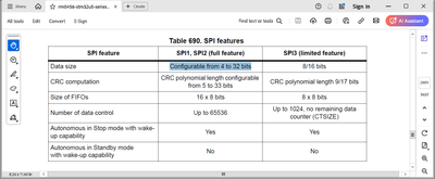

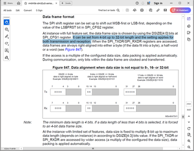

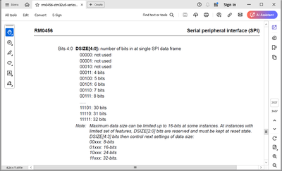

U5 has 4..32bit!
reference manual, page 2888, 68.2:
"From 4- up to 32-bit data size selection or fixed to 8-bit multiples"
page 2904:
As I understand:
- 20bit should be directly possible (or even as 5x 4bit, 2x 10bit)
- Just: not all SPIs are "full feature"
