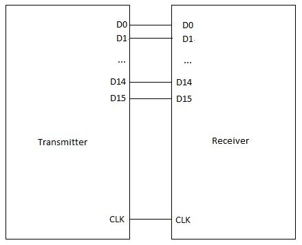

I want to transfer some data between two microcontrollers via 16 lines of data and one clk line.
(Based on STM Application note AN4666 ''Parallel synchronous transmition using GPIO and DMA'').
I use two STM32f407 for this Application.
In transmitter side micro puts 16 bits of data on port when clk line goes high(Rising edge).
In receiver side I want to read 16 bits of data from Port when clk line goes high and put them
into Tx_Buff array via DMA.
I want when the rising edge of clk has been detected by Timer8-CH4(PC.9) -which configured in input capture mode-
it acts as DMA trigger for transmitting the 16 bits data to TX_Buff.
Finally I expect DMA Interrupt occurs when 750 transfers completed.
While testing, the Transmitter side works fine (clk and data) and I monitored them in Logic analayzer and the Timer works fine too, but the problem is DMA not triggering (I'm sure of it because I check the registers) so as follow, no interrupt occurs in receiver side.
This is my code.

Posted on November 04, 2017 at 14:07
Do you have any idea?
You want to trigger using TIM8_CC4, not TIM8_UP
Per Reference Manual that would be DMA2 Stream7 Channel7
dma.DMA_PeripheralBaseAddr
= (uint32_t)&GPIOE->IDR; // Input Address
Assuming PC9 is correct..
Set up timer properly
RCC_APB2PeriphClockCmd(RCC_APB2Periph_TIM8, ENABLE); /* TIM8 clock enable */
TIM_ICInitStructure.TIM_Channel = TIM_Channel_4; // TIM8_CC4
TIM_ICInitStructure.TIM_ICPolarity = TIM_ICPolarity_Rising;
TIM_ICInitStructure.TIM_ICSelection = TIM_ICSelection_DirectTI;
TIM_ICInitStructure.TIM_ICPrescaler = TIM_ICPSC_DIV1;
TIM_ICInitStructure.TIM_ICFilter = 0x0;
TIM_ICInit(TIM8, &TIM_ICInitStructure);
TIM_CtrlPWMOutputs(TIM8, ENABLE); /* TIM Main Inputs/Output Enable */
TIM_Cmd(TIM8, ENABLE); /* TIM enable counter */
TIM_DMACmd(TIM8, TIM_DMA_CC4, ENABLE); /* Enable TIM8_CC4 DMA Requests */
Don't enable interrupt until the service routine is done
