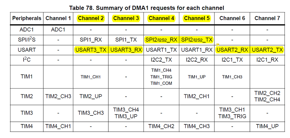

I use STM32F103, DMA1->CH6
USART2 RX and TIM3 TIM3_CH1 both can use this channel.
If only
USART2 RX or TIM3
TIM3_CH1 to use this channel,it is ok!
but how to multi use for two request?
thank you very much.

You can't.
Couldn't you use a different channel of TIM3, mapping to different DMA channel?

TIM3_CH1
 request only map to DMA channel 6.
Posted on October 30, 2017 at 09:58
Before I design a board schematic, I print the alternate function table and the DMA channel tables to make sure there is no conflicts. Now this is done by CubeMX to avoid challenges ahead.
Use a different timer channel or different time or a different usart, if the pinout is compatible.

Based on that picture I assume you have already occupied channel2 to channel 7.
Can't you use TIM4_CH1 or TIM2_CH3 for the DMA, maybe without redesign of the board, for example employing timer chaining in some way?
Posted on November 04, 2017 at 11:00
hehe, you are right. Actually, from ch1 to ch7, all be used!
Instead, use interrupt to handle request.
