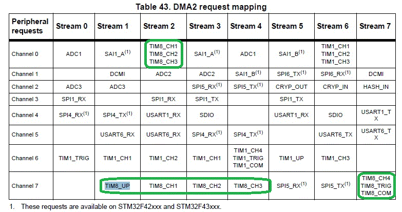

Given an F4 (F405 and F429) or even F2 ..
Is it possible for a DMA to be both MemoryToMemory and have the rate of delivery be set by a timer?
ie: I'm effecting a copy from an array in RAM, to a GPIO. (a byte at a time, say, otherwise I could use SPI tricks.)
With MemoryToPeripheral I think you can do it, but is M2M full speed only?
Or is it possible to refer to a GPIO as a peripheral somehow?

For TIM8 the channels/streams are defined in the Reference Manual RM0 The specific pin designations for the channels can be found in the
http://www.st.com/st-web-ui/static/active/en/resource/technical/document/datasheet/DM00037pdf
for the specific part.
