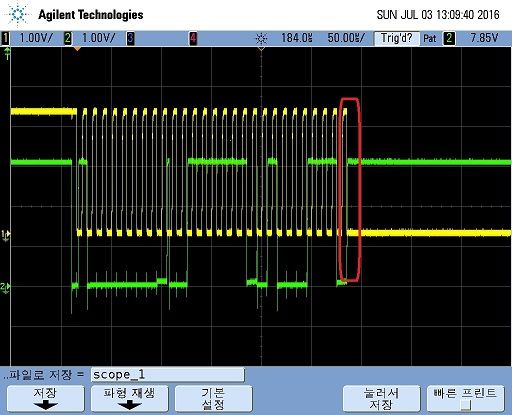

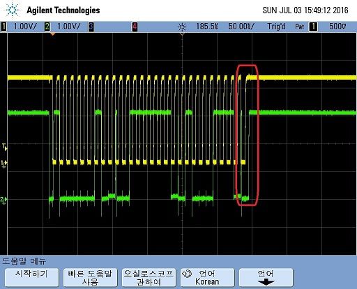

Posted on July 03, 2016 at 10:49
I generated the code using the STM32CubeMx.
I'm trying to I2C communication between STM32F4(master) and IC(slave, 7bit address).
I tested to two functions for I2C communication.
HAL_I2C_Mem_Write is OK, but HAL_I2C_Mem_Write_DMA is fail.
Test condition and setting parameters are same only except the function.
please let me know why HAL_I2C_Mem_Write_DMA() is didn't work.
thank you.

         data[0] = 0x47;
         error = HAL_I2C_Mem_Write(&hi2c1, 0x82, 0x3f, 1,  data, 1,100); //succeed
         error = LT_I2C_Write_DMA(&lt_i2c1_, 0x82, 0x3f, data, 1); //fail
success: HAL_I2C_Mem_Write(Dev Add: 0x82, Mem Add: 0x3f, data: 0x47)
FAIL: HAL_I2C_Mem_Write_DMA(Dev Add: 0x82, Mem Add: 0x3f, data: 0x47)

6740493
Posted on May 03, 2017 at 15:42
Hello.
When you use
 it's freeze because master doesn't send Stop
condition. You must enable I2C event interrupt. In this interrupt call I2C_MasterTransmit_BTF for generate Stop condition.
Regards
