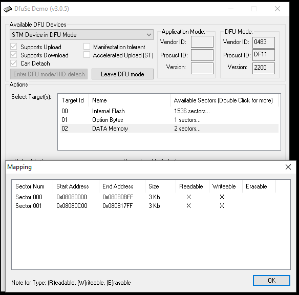

I have a Problem with the DfuSe Demo (v3.05) and the STM32L073CZT  on chip bootloader.
It is not possible to upload or down Load from/to the InternalFlash.
Downloading or Uploading the DATA Memory is possible.
I have tried it with our own borad and a nucleo board both the same problem!
Does
anyone knows what the problem is?
Is it a Problem from the STM32L073CZT  chip or from the DfuSe Software?
The X for Readable Writeable and Eraseable are missing for flash memory (we have no protection activated ).

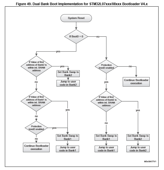

max239955_stm1
Posted on September 26, 2016 at 20:23
Hi Hannibal,
the boot pin s are so configured that the SMT boots from System mem. (nboot1 is checked (standard (
factory
) config ) and boot0 pin is connected to Vdd ).
the BFB 2 bit is in standard (
factory
) config (because i am currently not at work i can?t say it
exactly but i think it is checked
(we would have connected Boot0 to vss but the left tree form fig.49 form AN2606 won?t work it never end in the bootloader. so we have connected boot0 to vdd and I hope we can kill the repeatedly starting bootloader by enabling Protection Level 2)

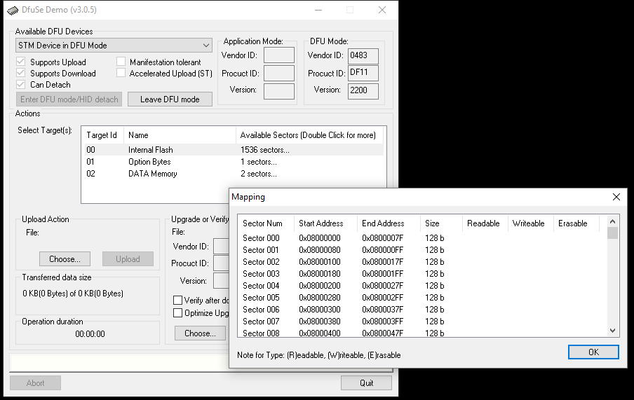

Posted on October 23, 2016 at 21:50
We use DfuSe Demo 3.0.5, and have same problem with STM32L073CZ. When click to ''Upgrade'' button PC app very quickly (around 3 seconds) do programming and say that all Ok. But after click on ''Leave DFU mode'' don't work. See picture. STM32 is stay in DFU mode.
We try old (but in new archive with DfuSE Demo 3.0.5) STDFUTester.exe and it show all that work (erase, donwnload, leave Dfu mode) but nothing is changed. We try old drivers, and new drivers 3.0.5 for STM32 DFU Bootloader device.
Also, try command line utils, same is happened.
Do you resolve this issue, and how?
