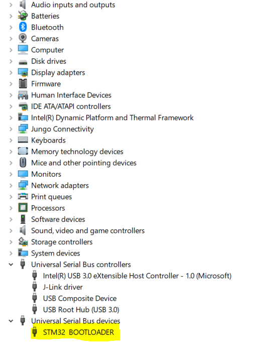

I have implemented my own bootloader in flash starting from 0X08000000 and the application program runs from 0X08010000 and everything works fine , but after doing this the dfuse demonstrator not able to detect board in dfu mode, as i know the in system bootloader should be in system memory which is one time programmable and i dint touch that part at all, but why this problem ?

Make sure BOOT0 is pulled high when you plug in and power up the board.​
Vprabhu
Yes, i already done that , when i check on my Device manager it shows STM32 BOOTLOADER instead of STM32 in DFU MODE under USB device

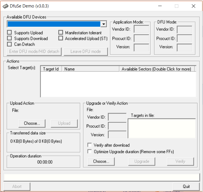

can you make a screenshot from dfu demo?
Vprabhu
Thank you, Attached here are the images , the dfu demonstrator does not recognize the board and does not display the board info. 0690X000006CFdGQAW.png0690X000006CFdBQAW.png
Very odd, this is with a STM32F429 based board?
